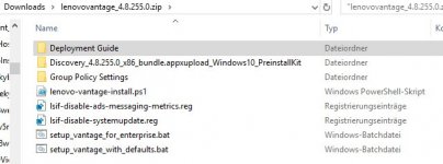

Habe in einen Beitrag hier gelesen, dass jemand, der der Lenovo Vantage skeptisch gegenüber steht, mit der oben verlinkten Version sehr zufrieden ist. Daher meine Nachfrage. Wenn das allerdings nicht für einzelne ThinkPads gedacht ist, dann hat sich die Frage somit erledigt.

Aus dem Deployment Guide des oben verlinkten Pakets:
Lenovo Vantage Application
Lenovo Vantage is a Windows 10 Modern Application that can be installed directly from the Microsoft Store (https://www.microsoft.com/en-us/store/p/lenovo-companion/9wzdncrfj4mv).
Lenovo also makes available the appxbundle (and related files) that can be used for side-loading. This type of installation can be performed using commands provided by Windows 10. For more information, please refer to the following Microsoft documentation: https://technet.microsoft.com/en-us/library/dn376490(v=wps.640).aspx
Lenovo System Interface Foundation (LSIF)
The installer for the Lenovo System Interface Foundation must be downloaded from the Lenovo Support Web site (https://filedownload.lenovo.com/enm/sift/core/SystemInterfaceFoundation.exe). Installation of this package can be performed silently as follows:
SystemInterfaceFoundation.exe /verysilent /NORESTART /type=installpackageswithreboot
Note that the PC must be rebooted after installing Lenovo System Interface Foundation.
Deployment:
Lenovo provides a batch file “setup_vantage_with_defaults.bat” that will deploy both the Lenovo Vantage application as well as Lenovo System Interface Foundation (LSIF), in the same way that it is installed in the factory preload. The batch file is intended to be executed from an administrator command prompt.
Lenovo also provides a batch file “setup_vantage_for_enterprise.bat” that will deploy with some features disabled (as described in Chapter 4 of this document).
Setzt also ein Active Directory voraus.
